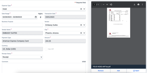

  1. From your open expense report, click the line item expense entry. The details view opens.
  2. On the right side of the details, you will see the receipt image attached.
  3. Click Remove.

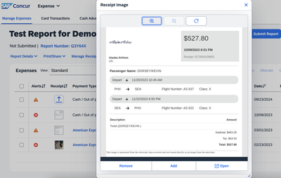

  1. When you first open an expense report, you will see all the entry line items. Click the image thumbnail for the entry that needs the receipt to be deleted.
  2. The receipt image opens. Click Remove.
