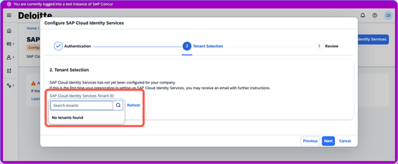

I have been struggling since few days when I decided to setup the User Provisioning between our IAS tenant and our Concur Partner Demo Entity.
Firstly, I wanted to configure Joule for our Concur Demo instance as I did with our Partner Demo for SAP Ariba, SuccessFactor and S4 HANA Public Cloud. However, my initial ticket didn't move because it seems there is a legal issue to activate Jouel for Partners...so I gave up on Joule.
Secondly, I decided to configure the user integration from SuccessFactor to SAP Concur, I was then told that this is not possible for Partner Demo, because for that Concur Technical Team needs to associate the entity ID to the Customer ID in SAP for Me...I don't know why this can't be done, because in the way we could use MDI Integration with SuccessFactor.
Thirdly, I decided to integrate the Users data via the SAP CIS/IAS/IPS using the user provisioning from IAS/IPS,  and use the standard setup that Concur is providing (See below secreenshot), but I quickly, I ran into issues as the IAS system is not linked...which take me to the second point above.
I asked this question to Concur via my initial ticket that was opened for Joule activation almost a year ago and it turned out, to activate Joule or MDI Integrtaion or user provisioning via IAS/IPS, Concur needs to add the entity ID to SAP for Me, that give the possiblity to use the automationm Concur provides for end Customer but Concur confirmed that this can't be done for Partner Demo System...I still don't understand why it can't be done?
However Concur guided me toward the SAP Cloud Identify Service document where I could configure an Application to setup SSO with SAP Concur via IAS and create a provisioning Source and Target sytems mabually and provision my user to Concur froIAS.
I followed the document to enable SSO and user provisioning manually, as I did many times for other tool.
But none of them were working initailly so I opened a ticket to Concur to help me and also to add the company domain to the domain list in Concur. Thanks to the Support Team the SSO works fine but the user provisioning has always failed and I am always getting this error below in SAP IAS.
What is interesting this error is happening regarless if my application is Concur "OAuth 2.0 Application Management" is on Dev, Test or Production, and the error happen even when the Application is deactivated in Concur. But there is an issue with the ticket in Concur which seems stucks because of who to handle the ticket.
I opened a SAP ticket andd I had lot of call with CIS/IAS Support Team who said that it all seems OK from IAS and will forward the ticket to Concur...and I am still waiting...
My questions are:
  • Does anyone faced such error and how to fix it?
  • Why Concur can't link the Concur entity to SAP for me as it is for all the other Partner SAP Test Demo and Development  (TDD) systems like Ariba, SFSF, S4, BTP and more?

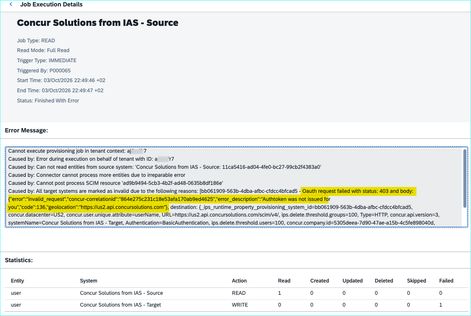

Please, find below the exact error on IPS logs
Caused by: All target systems are marked as invalid due to the following reasons:
  • Oauth request failed with status: 403 and body:
    • error: invalid_request
    • concur-correlationid: 8dd381f791d01ca3c58f6232e5d0f131
    • error_description: Authtoken was not issued for you
    • code: 136
    • geolocation: https://us2.api.concursolutions.com
Please note that Concur has mentionned that they can't link the Partner Solution on SAP4Me.
Below is the target system config in IAS.
Also see the configuration of the SCIM 4 API at Concur side
And note that the App Stage which is "Test" was checnged to Dev and Prod, but it didn't have an impact on the Error.
Based on the error message, I suspect this might be related to the company request token. Could you please try generating a new request token, update the configuration with the newly generated token, and test whether this resolves the issue?

Thank you fot your insight, but I updated the scope, changed app type back to Development, generated a new auth token and i have the same and exact issue.
I felt like, whatever I do in Concur, the error remains the same. when i don't enter the correct auth tken, i get the message token doesn't start with "at-" but that is the only different message I am getting, all the reste is the same below message ""Authtoken was not issued for you""

The HTTP 403 / Error Code 136 – "Authtoken was not issued for you" indicates that SAP Concur is rejecting the OAuth token request. This points to an authentication/authorization issue before user provisioning or SCIM attribute mapping begins.
Recommended checks:
  1. SAP Concur application authorization: Ask SAP Concur Support to verify that the application is correctly registered and authorized for the intended Concur company.
  2. Partner Solution linking: Since SAP Concur cannot link the Partner Solution in SAP for Me, request investigation of the application entitlement/authorization relationship. This is a potential cause, not yet a confirmed root cause.
  3. IPS target configuration: Verify concur.api.version = 3 for SCIM v4, the correct concur.datacenter, Company UUID, and company domain.
  4. Company Request Token: Verify that the token was generated for the correct company and used within its 24-hour validity period. If necessary, generate a new token and rerun provisioning.
  5. Existing refresh token: If provisioning previously worked, check whether the stored refresh token is still valid.
Changing the App Stage between Test, Dev, and Prod would not resolve a missing company OAuth authorization by itself.
Recommendation: Escalate to SAP Concur API Support with Error Code 136 and the correlation ID so they can identify the exact reason for the token rejection.
