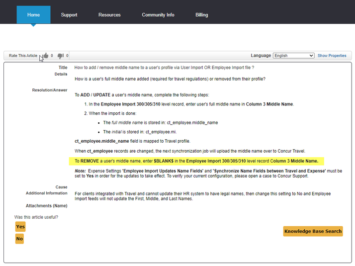

@KevinD / @SteinerNC - I am trying to do something similar with duplicated middle names, however, no matter what I have tried to remove the data, it does not work. I have tried the following - nothing in the field, NULL, BLANK, "" - in the case of nothing in the field, the middle name remains as it is defined. As for NULL, BLANK, and "", the middle name updates with these words/symbols. I cannot find any documentation on how to null out data in a field. I also posted about this yesterday. Hoping to come up with a solution rather than having to modify each one individually and manually.

I found this article in Contact Support Website: CTE Customer Portal (salesforce-sites.com)

Thanks @cjmarimo - Unfortunately, it did not work using the User Import functionality. We would have to make a code change to try to send it in our interface. Here is what I got when using the import process through User Administration:
