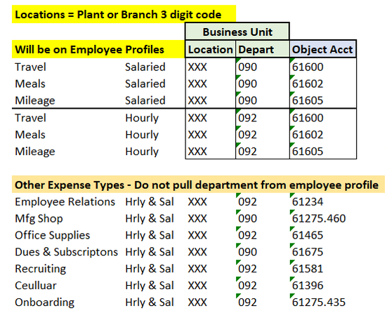

My company is currently working on our Concur build and ran into an issue with the coding. We have been informed that the GL coding will derive from the employee profile pulling their "Business Unit" and "Department" and then the object account based on expense type pulled from a background table. Which in the case of the 3 main travel expense types this will work as we split travel, meals and mileage by salaried (fixed cost) and hourly (variable cost) employees. But we have additional "other" expense types such as Employee Relations, Recruiting, Mfg Shop Supplies, Dues & Subscriptions, Education, etc. in which only the business unit is relevant and the department code would not be based on the employee profile. The expenses just mentioned fall into either fixed or variable, but never both. How can we configure our Concur build to understand that if an employee request to be reimbursed for "Employee Relations" expense type and they are setup as business unit 211 and department 090 that only the business unit should be looked to and department ignored? In this case the correct business unit and department would be 211 + 092 and the object account being 61234. I pressed our consultant on this and she made it seem as if this is a complex request. Is there not a way to build logic that states if expense type is B (other expense types non-travel) than system will look to a background table for coding and when expense type is A (travel, meals, mileage) pull from employee profile business unit, department, and the table for the proper object account? Or possibly all coding is pulled from a background table and the only field referenced in the employee profile would be the business unit which will aid in selection of the proper coding from the table in conjunction with expense type? Ultimately what I am trying to avoid is manual corrections needing to be done when preparing the monthly financials. If we are going to implement a system to streamline our T&E process I want to make sure we are not adding work to others. Hope this all makes sense. Any and all suggestions are welcome and please let me know if you need any clarification.

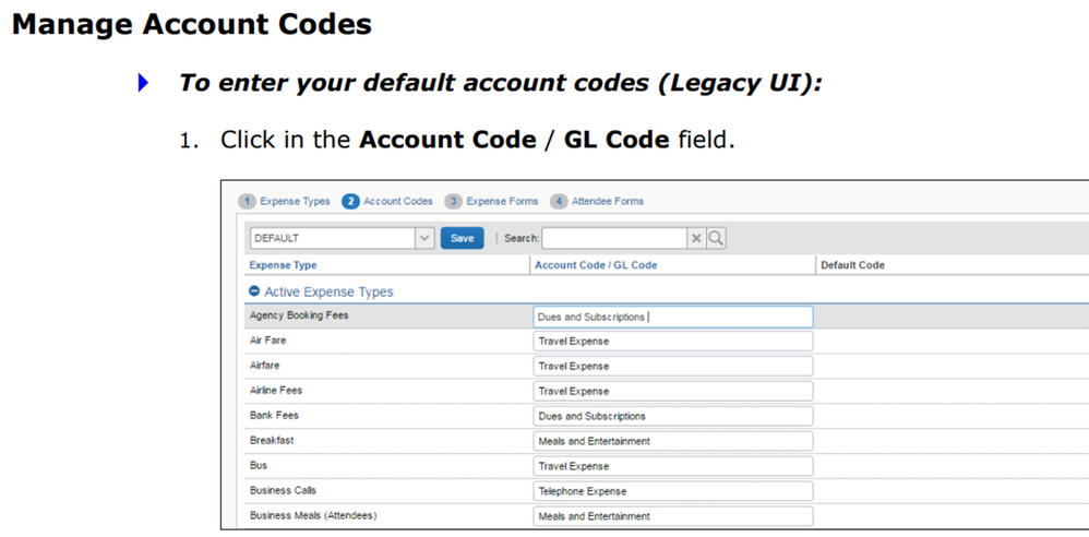

GL Coding is mapped to expense types, so you can certainly create a hierarchy to map an expense type's GL Code to a business unit. However, this information must be entered manually. Which means, if you have 100 business units and all need to have a unique GL Code for expense types, you will be doing a lot of manual work. Then multiply that amount of work by the number of expense types you want to map.
If you don't need each business unit to have its own GL Code by expense type, I think I have an option for you.

I like the idea of a hierarchy by business unit, where the only field pulled from the employee profile would be the business unit and the next field to be referenced would be expense type and based on business unit and expense type the account code table would be referenced for "Business Units + Expense Type" to complete the full GL coding. Is that something that is possible?
Here is a sample of the data:
@smojica I believe it is possible. However, to be able to do this you would need the correct permissions within SAP Concur. Do you have full site access or does someone at your company have full site access? If not, then your two options are:
1. Take our Advanced Configuration Training to gain full site access.
2. Submit your request to SAP Concur Support.
Likely option 2 will be much cheaper and likely faster.

@smojica definitely sounds like it is one of our employees. Do you plan to use just one GL Code per expense type? From the example screenshot it looks like that is the plan as your Salaried and Hourly GL Code for the expense type Travel both look to be 61600. What will distinguish expenses for account string purposes is the Business Unit and Department, is that correct?
In other words, no matter what business unit or department and employee is in, the GL Code/Account Code for an expense type will not change. So, the Travel expense type will always be coded as 61600 no matter who is submitting the expense, is that right?
@KevinD The example provided was the impact to our plant locations, but we also have branches/corporate in which then creates two separate object accounts that could be used for travel either 61600 (plants) or 71600 (branch or corporate)
