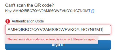

Thank you for answering, This is what we are getting when we try to setup on website. I just tried this so code is fresh.

carlosgomez
For anyone getting this error, the issue is that they are scanning the QR code with the phone's camera directly, not with an Authenticator app (notice how the key matches in the screenshot above). To resolve this, install an Authenticator app allowed by your organization, and then follow the steps for that app to add a new entry (which requires scanning the QR code, or entering the key manually). Hope this helps.

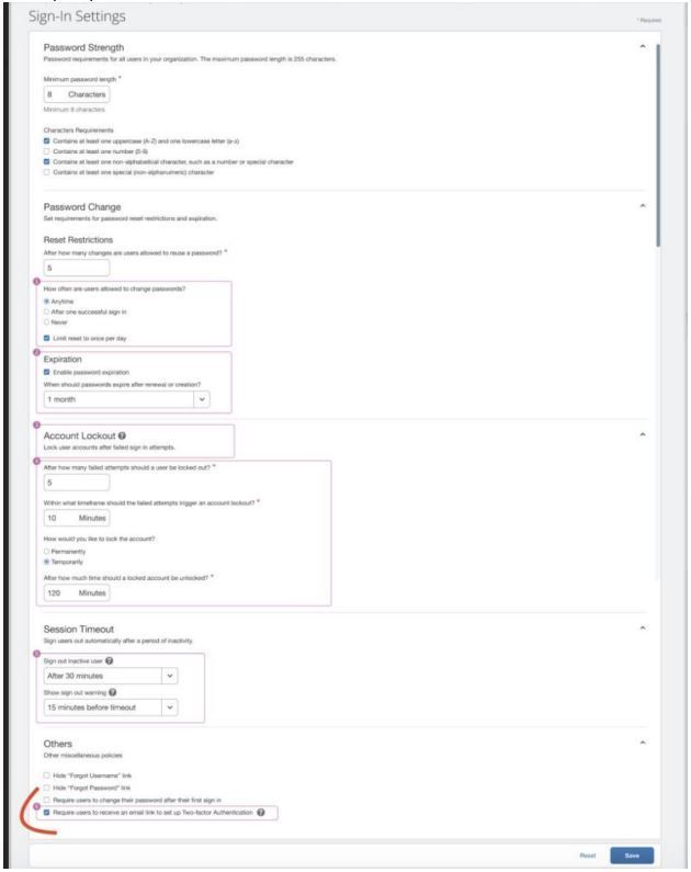

cheesus23
New Member - Level 2
we have been having this issue, that when 2fa is set or or trying to set up the 6 digit code is never accepted
we tried via verified ID's in the auth app to no avail
after some digging found a fix
for a quick explanation behind it:
if you have SAP open in 2 chrome tabs, tab 1 gives the QR, you then lopad on tab 2 and get the QR, and scan from tab 2 - it fails, as it requires the original QR from tab 1
my company had the setting to email a QR code link to users when setting up MFA, which i beleive is causing the above, the original log in tab has an "Invisible" qr of sorts, and the emails link generates an invalid 2nd QR code
we switched off the email QR link, and reset users MFA, and so far all tested ones have worked first time
se below for the setting at the bottom
