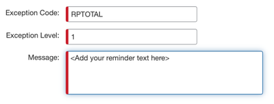

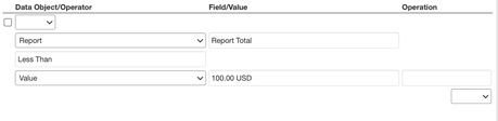

@sunilrathod if you want users to see a message reminding them to submit reports with a total greater than $100, you can create the rule. See below. Keep in mind, this will still allow them to submit. I would also suggest setting up an email reminder that uses the same conditions that when users have a submitted report less than $100, they will receive an email stating they should add more expenses if possible.
Audit Rule Condition
Exception
You will need to type in the message you want the users to see when they submit.
