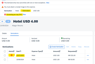

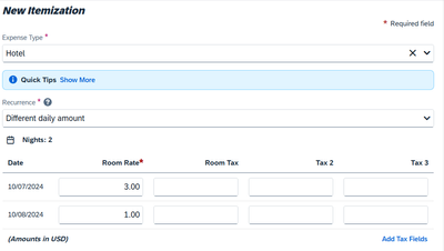

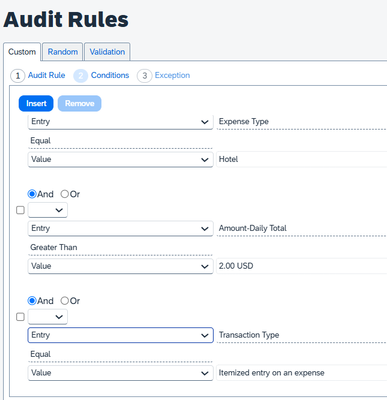

Alternatively, you can continue using itemization and make it required where user can put per day rate if it same for all day and system will auto create those many days itemization. If rates are different for specific dates then user can use different rate option and input that as shown below.
WIth this, you can write custom audit rule and check whether daily amount is getting exceeded allowed limit for the specific city.
