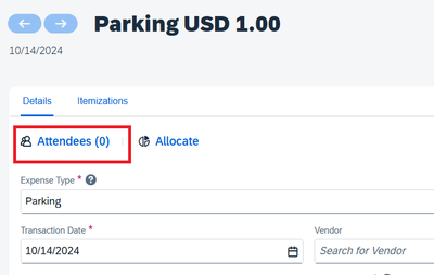

1. Create expense entry
2. Click on Attendees option as shown below

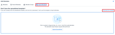

3. Click on Add button
4. Click on Import Attendees option and download template

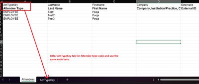

5. Open downloaded template and update it with attendee details as show below.

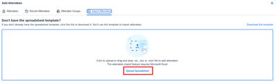

6. Upload template using Upload Spreadsheet option and click next, next, done.
7. All attendees will get added successfully.

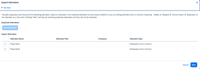

Also, system will give pop-up msg after uploading sheet if there are any duplicates as shown below. This duplicate check is based on the backend attendee type configuration. Example, If check is configured on first name and last name and company name then system will reject all such records where first name, last name and company name is same for multiple records.
Please note that duplicate check criteria could be configured differently for each attendee type. It is totally based upon, how configuration is done in backend. Based on that system will behave and in such cases, system will skip duplicate records during upload.
