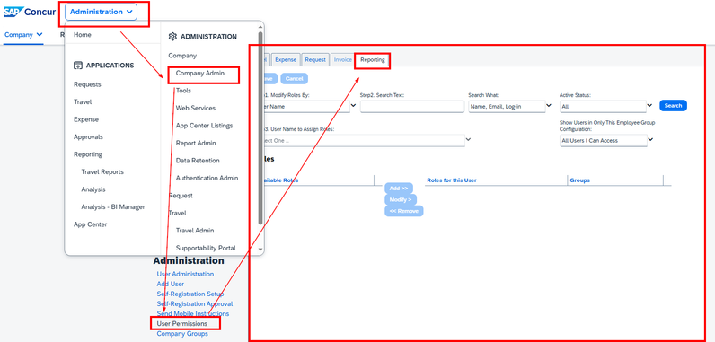

Hello @weacar1
You must have permissions to view the reports. Once they are assigned to you, it takes 24 hours for them to become effective.
Permissions can be given by the company's Concur administrator.
To add permissions: Go to Administration-> Company Admin->User Permissions->Reporting

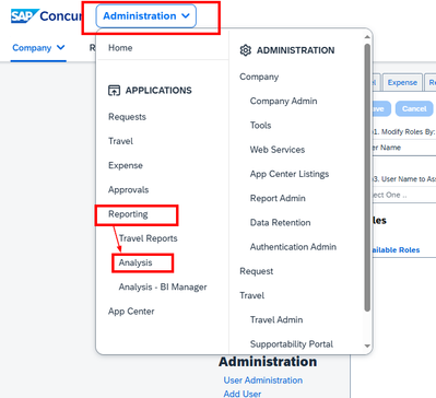

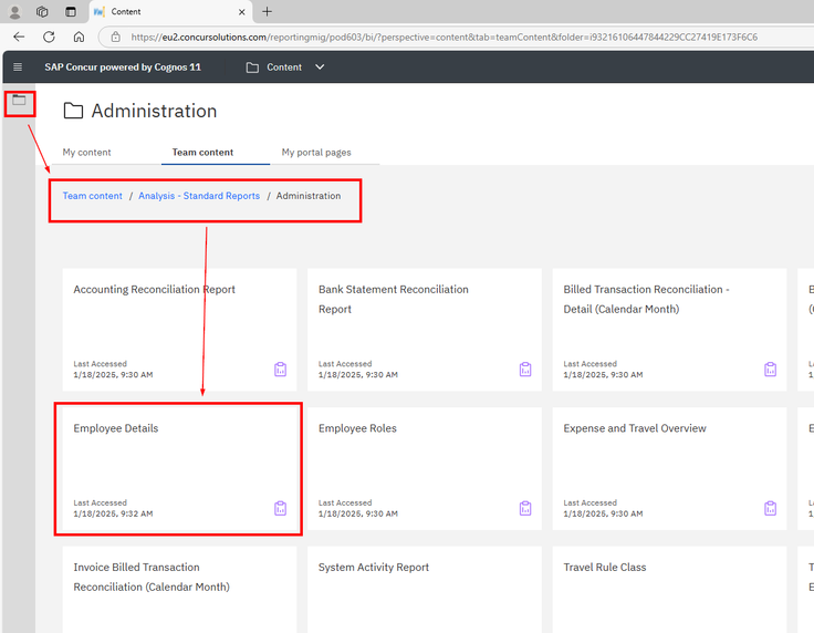

Once the permissions are effective, to access the reports:
Go to Administration->Reporting->Analysis
And the Cognos reporting tool will open.

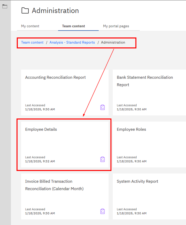

Goto Team content->Analysis - Standard Reports->Administration-> REPORT Employee Details
Thank you, I have the report but cannot seem to export it.
How do we alter those permissions?
