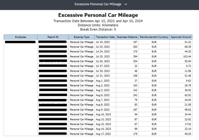

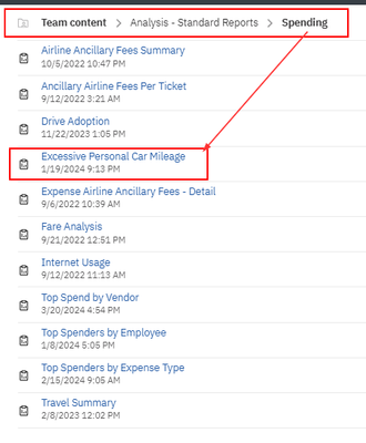

Hi @Andrea1
To obtain the mileage of a user in a period I use standard report " Excessive Personal Car Mileage"
Report " Excessive Personal Car Mileage"
Transaction Date: the date range
Distance Units: select “Miles” or “Kilometers”
Break Even Distance: 0
Employees: select employee
I obtain the breakdown of all Car Mileage expenses incurred by the employee during the selected period.
Then I export this file to Excel, and sum up the mileage.
BR,
cj

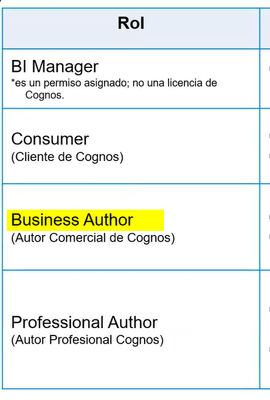

I don't know if it could be because of the Role.
There are the following roles:
The one I have assigned is "Business Author"
BR,
cj
