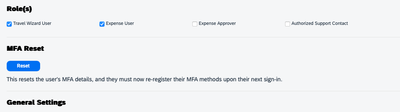

Looks like a reset button has been added to the user pages.

Where did you find this button? I couldn't find it under their user profile. I am trying to reset some of our user's 2FA because their codes are not allowing them to login.
kberwin
Occasional Member - Level 2
When you are in the User Administration area and go into a user's record, it's at the top between Role(s) and General Settings.

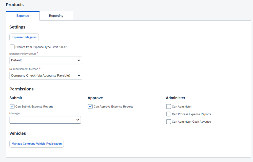

ACCTALeeP
Mine does not look like this and the "MFA Reset" section does not exist.
This is frustrating because 2FA seems to work for some individuals but is broken for others.

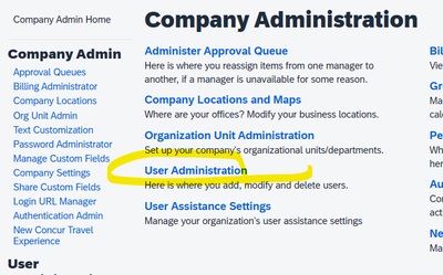

rphelps
Occasional Member - Level 3

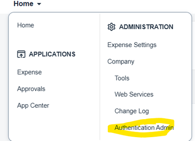

Looks like you are in the wrong user area.  You should be in the Company Admin Home area.  I went to that spot initially as well looking for the button and then found it in the "other" admin user maintenance area.
I got there with the following clicks.  Surely easier but i havent located yet.
Click Home in upper left
Under Admin on right click Authentication Admin
Click Sign-In Settings
up at the top, there is a navigation string that you can click "Company Admin"
Then navigate to User Administration.
select user and reset is at top
ACCTALeeP
Wow, that was certainly hidden in the new user interface layout update.
Thank you for all your help!
