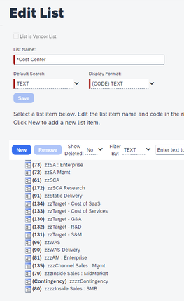

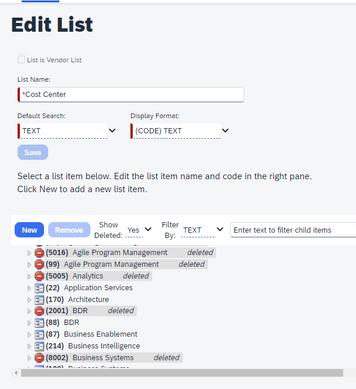

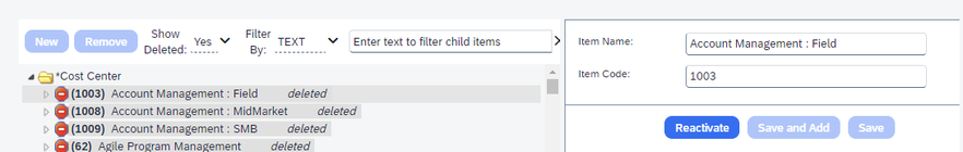

Hi @KevinD.  I'm resurfacing this resolved question to dig a little deeper, if possible.  If deleting an item (actually "Remove" on list management) doesn't affect historical data, why was my previous admin advised to add "ZZZ" or something like that as the prefix now?  I can't imagine that we wouldn't have just removed them if we could, and the clutter is driving me nuts.  Someone actually picked an old ZZZ cost center last week.  I also see items that have been "deleted" when you click YES for show deleted.   And if you can "Reactivate" a "deleted" item, why is it such a big deal and seems so ominous with the "irreversible loss of the items" warning, when it actually seems to be reversible?     Thoughts?
Basically, I want to clean up the mess of items in my system, but don't want to affect anything historical.  Please help!  Thanks!!  🙂
@dbetti See my responses in red.
I'm resurfacing this resolved question to dig a little deeper, if possible.  If deleting an item (actually "Remove" on list management) doesn't affect historical data, why was my previous admin advised to add "ZZZ" or something like that as the prefix now? I cannot say for sure, but possibly at the time restoring list items wasn't a function since in the set up guide update that happened in October 2023 the Restore List Item content was added. That way if you just put ZZZ, you don't delete the item and would not have to re-add the item if you decided you did need it in the future. With the Restore option now available, I think using ZZZ is no longer something that would be needed.
I can't imagine that we wouldn't have just removed them if we could, and the clutter is driving me nuts.  Someone actually picked an old ZZZ cost center last week.  I also see items that have been "deleted" when you click YES for show deleted.   And if you can "Reactivate" a "deleted" item, why is it such a big deal and seems so ominous with the "irreversible loss of the items" warning, when it actually seems to be reversible?     Thoughts? Again, not sure on this, but I think this window just wasn't updated to go with the Reactivate function. Also, I think it might just now be a confirmation that you do actually want to delete the item.

Thanks, @KevinD.   So (just to confirm), I really can "DELETE" an unnecessary item from a list and reactivate it later if needed?  And deleting an item in this manner will still show the item in historical reports?  Deleting it just removes it from the visible choices to end users, is that right?
@dbetti from what I read, that is correct. The Reactivate option won't be available for sub-items if the parent isn't active. That is one thing to keep in mind.
