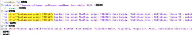

Hi @cjmarimo
How did you get just the top row blue? Every time I try, it colors the entire table. 😕
Thanks,
Karen
Hi @KFriedhoff
I have defined the color in the table header.
<tr>
<th style="background-color: #005cb9; border: 1px solid #1a85ec; color: #ffffff; font-family: 'Helvetica Neue', Helvetica, 'Segoe UI', Arial, sans-serif; font-size: 12px; font-weight: normal; padding: 1px; width: 43%;">Cambios y cancelaciones de las reservas</th>
<th style="background-color: #005cb9; border: 1px solid #1a85ec; color: #ffffff; font-family: 'Helvetica Neue', Helvetica, 'Segoe UI', Arial, sans-serif; font-size: 12px; font-weight: normal; padding: 1px; width: 28%;">Viajes</th>
<th style="background-color: #005cb9; border: 1px solid #1a85ec; color: #ffffff; font-family: 'Helvetica Neue', Helvetica, 'Segoe UI', Arial, sans-serif; font-size: 12px; font-weight: normal; padding: 1px; width: 28%;">Formación</th>
</tr>
