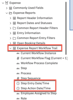

@Suhas123 I can direct you for the 1st and 2nd Level data items since they are in a folder not very commonly used.
For the other data items, they are a bit more common, so I'll let you find those. If you aren't sure where to start, just use the built in search option.
If you look in the data warehouse you will see under Expense>Expense Reports a folder named Expense Report Workflow Trail. I've highlighted a couple of data items for you that will show you the Step of the workflow, when the report entered that step and when that step was completed.
This should get you going.
