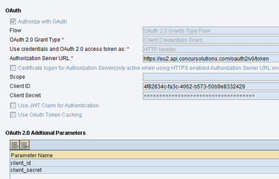

this is connecting from SAP PO with REST adapter( same with Postman) to use Concur API.
And using OAuth2 flow with grant_type client_credentials .

Our APIs will only work with Password grant type or Refresh Token grant type. The Client Credentials grant type is for Event Subscription Service (ESS) v4. The access token will not work for our APIs if password/refresh_token grant type is missing.
