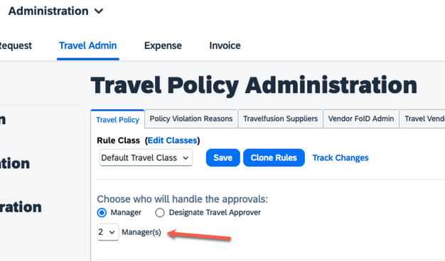

@heyden for Travel you can have two managers approve. However, the way it works is the traveler's manager approves the trip first then it goes to the manager's manager for second approval. From what you said, you want the traveler's manager to approve then someone from the GA team, What you would need to do is make sure all your managers on the travel side have someone from the GA team set as their travel manager.
You would also need to make sure the setting shown below is set to "2".

@heyden Kevin is correct. To add onto what Kevin advised, the only way the Approval Process works in Travel is:
In the configuration, if 2 is selected, all trips that require approval are routed to each user's manager and then:
♦ If the user's manager approves the trip, the trip will then be sent to the
manager's manager (as listed in the manager's profile).
♦ If the user's manager approves the trip and the manager's manager
approves the trip, then it is sent to the agency for ticketing.
♦ If the first manager rejects the trip, the trip will not be sent to the second
manager. As usual, the user will receive an email advising that the trip
was rejected.
♦ If the first manager approves the trip and the second manager rejects it,
the first manager will not receive email notification of the rejection but the
user will.
I do also want to advise that in the new Concur Evolution of Travel experience, there will only be the option of having one Travel approver, either the Manager designated in the Traveler profile or a single Designated Travel Approver for the Rule Class.
