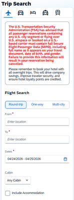

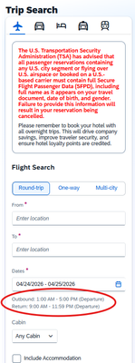

Here is a screenshot to show what loads on the main page when I start a new search -

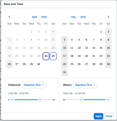

The part that is circled is new. I have never seen this before. When I click the calendar button to change the date, I am able to change the outboud and return windows.
When I expand the times to anytime and go back to the search page, you can see that the flight windows are no longer listed. This is how is used to be for me when I started a new search. Something changed this week somehow.

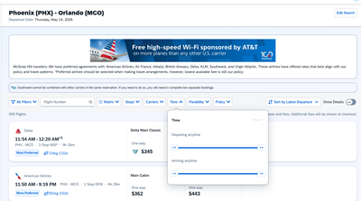

After I change the window to anytime, I search for a flight LGA to ORD.  It shows me the results for anytime. Here is a screenshot of what shows when I click "edit search" on the results page.
If I change one of the airports on this screen, it changes the flight time window back to 1:00am-5:00pm
