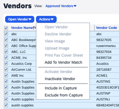

@monteypoo vendors cannot be deactivated with the template. However, you can deactivate several vendors at once. See my screenshot. I'm guessing you asked about using a template so you can deactivate several vendors at one time, correct?
On the Vendor Manager screen, change the view to Approved Vendors, select all that need to be deactivated, then use the Actions button to get to the option to deactivate.

Thanks @KevinD , unfortunately this isn't what I was hoping for as I have around 300 accounts that need inactivating so selecting them one by one across multiple pages will take us some time, but it sounds like this is the only option.
