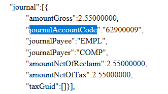

  1. Check the JSON file sent from Concur to SAP: How can I check the data posted from Concur to SAP ICS (JSON file)?
  2. Find the entry from the G/L account in the JSON file.

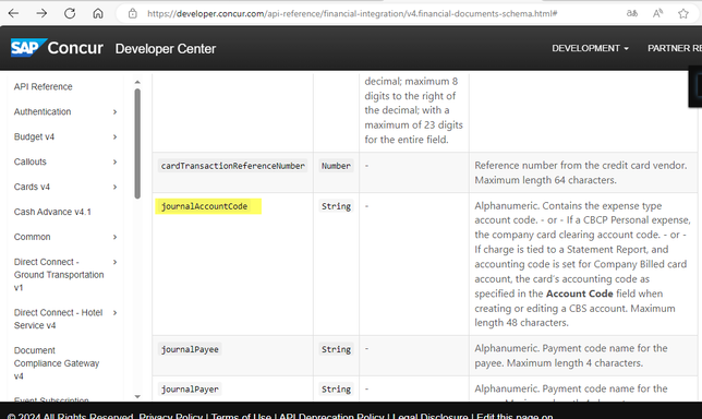

Note: Usually the G/L account will be in the JSON field "journalAccountCode" meanwhile the entry can be found under field "expenseTypeName".

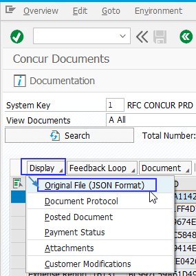

To get the JSON file information in SAP, please do the following:
1) Open your SAP System the financial document should be flowing to
2) Enter transaction CTE_SETUP>Financial Posting>Concur Documents (or access directly with tcode CTE_DOC_MONI)
3) Select the document you want to check by clicking on the beginning of the line
4) Click Display >Original File (JSON format)
5) You should now be able to see the JSON file.
Note: Please keep in mind this option brings always the latest JSON generated for this financial document.
Financial Document Schemas
Let us know if you have more questions!

Hello @SSeb20
Open the JSON code of the report in SAP ERP as indicated by @KevinD  and  @MelanieT.
Inside JSON Code search: "expenseEntry->allocation->journal->journalAccountCode"
Once you have the account, validate in SAP ERP, transaction FS00 if the account exists for the Company code, or ask your company's finance department.
