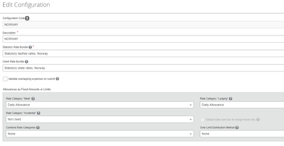

We are currently trying to configure teh travel Allowance of our Norway Implementation in Concur. I came across this setup below in the Travel Allowance Configuration under Configuration:
By default, Concur already has some pre-loaded Rate Bundles for Norway: State Rates and Tax Free Rates. In the screenshot above, does this say that for Norway, both State Rates and Tax Free Rates are going to be used? If the client decides to just use one set of rates, does that mean we just have to remove the value in Client Rate Bundle feed and replace the Statutory Rate Bundle field with whatever Rate Bundle they decide to just use? Just wanted to get some clarity on this.

@brandtp09 Hello!  I have attached the Norway TA Config Guide, is this what you have been looking at currently?   I also reached out to our Statutory team and asked them your question.  This is their response:  If they want to track over limit expenses, the setup should be as in the screen capture. If they do not want to track it in Concur, and pay taxable rates, then State rates should be in the statutory rate bundle, if they pay only tax-free rates, then it should be the only used.

@MelanieT, does this mean that the Client Rate Bundle field is not really something that needs to be filled out? What would be the purpose of this field, then?
