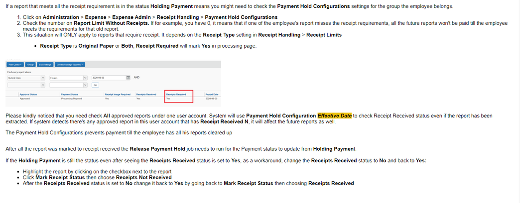

I noticed that for countries that I have already added to a Payment Hold configuration, once the receipts have been received, they get instantly released from the Payment Hold status. However, I added one more country to my payment hold configuration and even after the receipts have been received, they remain in Payment Hold status. Does it take a while before Concur recognizes the newly added country in the Payment Hold Release Job?
In such cases, can I manually run this job? Will it affect whatever schedule was set for it?

@brandtp09 Hello!  You can manually run the job, it will still run in the ONP as well. Here is also some info I found for Payment Hold:

How can we manually run the Release Payment Hold job?
