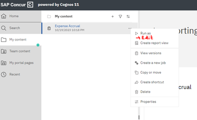

LDunne
@KevinD Thank you so much for that link!
I got as far as making a copy of the report to edit, however I don't have the edit option that's shown in the video:
Is my access or permissions limited?
Solution
@LDunne from what I see your site has Analysis and therefore you will not be able to edit this report. You will need to submit a help ticket to Concur Support to get this report changed.
