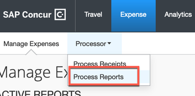

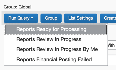

@RFruchter sign in to SAP Concur then click Expense at the top of the screen. Follow my screenshots to see reports ready for processing.
