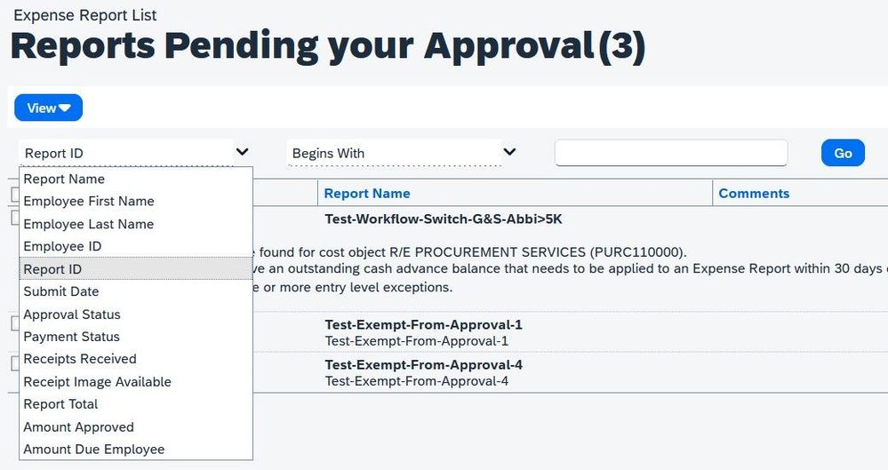

@TriciaW Hi Tricia, we've coordinated the migration from using Report Key to Report Number. However, this is also not in the report listing to search or filter by for our approvers as shown below. This was the reason behind my original question and you indicated Report Key was deprecated and we should start using Report Number. However, it's still not an option for them to search. Can you please assist with understanding how they can search on this Report Number? Thank you!
@kpick @TriciaW was referring to the Processor screen when referring to using the Report Number. The screenshot you provided is the view from an expense report Approver, not a Processor.
@KevinD Hi Kevin, yes, my original question was for our end users, not processors, saying that they need to be able to search on a value they see in their data. The recommendation was to switch to Report Number as Report Key is no longer an option. So now that we are transitioning to Report Number, is there still no way for the approvers or other end users to search their reports based on that value? If there's a place where an admin can customize the approvers' search value options, I haven't found it yet. And if there's not a way that they can search their approvals by report key OR report number, I need to find a way to get the 20-character report ID value into their ERP reports instead. Thank you.
@kpick unfortunately the list of options in your screenshot is not customizable.
