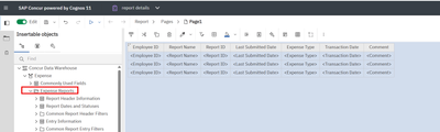

We would like to create a cognos report which include the details like expense type, transaction date, comments provided by user at expense entry level. Also need to include report header details like report id, last submitted date.
Meena_K
Occasional Member - Level 3
Hi @justinkthomas,
I have created a sample report including the requested field. Kindly review the screenshot for reference. All relevant fields can be found under Expense Reports
Please navigate to Expense Reports and select Report Header Information for all report-level details. For expense entry-level details, you may select Entry Information

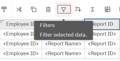

Hi @justinkthomas,
Please check if there is any filter applied for any of the fields.
Regards,
Meena
justinkthomas
No  @Meena  . I just checked the reporting permissions where my role was assigned to one specific group ONLY due to which when the report extracted , i was only able to see the details for that specific country only. I just assigned the global role. May be tomorrow i can get the correct output as it will take one day for Cognos to reflect the changes😊
