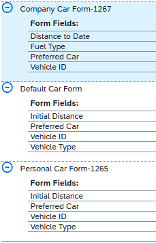

I am starting from there. But I will have to modify one of the Forms to get what is needed for UK Car Allowance reimbursements, correct. None of these (below) show the type of fuel nor engine size. So, I will have to add at least those fields and then create the lists so I can give the employees a drop-down of choices (bottom). Is there a better way?

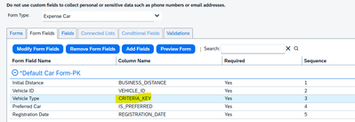

@JLovasz look for the CRITERIA_KEY field and check if it is added to your Car form or not. if not added, please add it and proceed.
This field gets the information from Car Criteria setup in Car Configuration/Mileage Service. you dont need to add any specific field to get this in user profile while creating the Car details.
