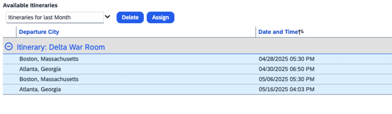

@nshluf okay, it looks like you somehow added travel dates of 05/06 through 05/16 to your two-day trip between Boston and Atlanta. See screenshot below. I think you need to delete this itinerary and manually create a new one that is for 04/28 through 04/30. Assign it to your Delta PI 2 Planning report. Not sure how those other dates got added to the two day trip, but I'm pretty confident that is what is causing the issue. To delete it, go to the report and click the Travel Allowance link. Select Manage Travel Allowance. You should see the itinerary at the bottom of the screen. Click any line of the itinerary to select it, then click Delete. Once deleted, on the same screen click Step 1. Create New Itinerary.
After you add the two-day itinerary to the above mentioned report, then create another itinerary for your Boston to Scottsdale trip. Currently the itinerary has you traveling from Boston to Atlanta with dates that overlap your travel dates to Scottsdale.
Does that make sense?
Let me know how it works it out for you.

Hey Kevin, thanks for the reply! I did check, and the dates do not overlap. It seems as if 2 separate itineraries appear as separate, but for some reason are merged together when I try to add them to separate expense reports. I just created both again and fixed all errors. The only thing missing from each is my Travel Allowance (per diem) that MUST be added before I submit. This is where I'm running into the error. Both are created now though so please take a look. If preferred I can delete the second one as well, if you want to just look at the first, but I thought it would be best to paint the whole picture first. Thanks! @KevinD
That worked!!! That all made sense, and thank you so much for taking an in-depth look. Now I know for next time. Weird circumstance, but much appreciated. I was able to submit both reports! @KevinD
