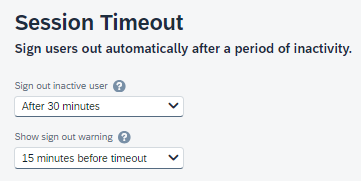

@Karthikhemadri try the Authentication Admin>Sign-in Settings. There is a session timeout option there.
Hi @KevinD you're right.
In our company, we use this policy on the website:
Maybe it's a little restrictive.
But you shouldn't keep an inactive session open for a long time for security reasons.
What is the limit? This is the policy decision of each administrator or/and company.
In the mobile application we have not appreciated that this policy applies to us.
