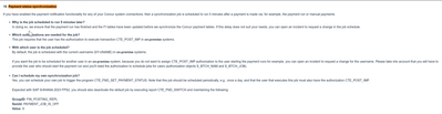

From our colleagues who own the SAP system landscape - they have provided some guidance on scheduling the synchronized payment status so that it occurs automatically.  Let us know if this solves your issue.

Thank you so much for the details, really appreciated. Yes we also identified issue regarding authorization to transaction CTE_POST_IMP and working with internal team to provide required access. I think this should resolve the issue.

Thank you so much for your help. Appreciate. The solution suggested in your post worked for us. This community is great place, looking forward to continued collaboration and contributing to it from my side as well.
