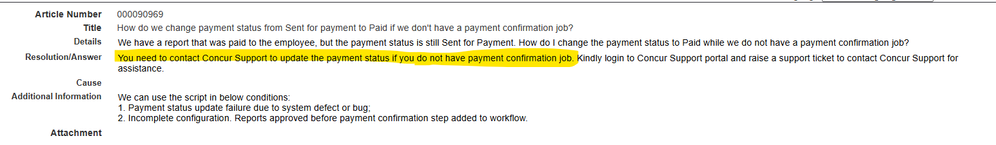

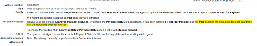

Hi @brandtp09 ,
With reference to below article, not necessary that payment reimbursement will happen on same day. Hence, we should not assume that Send for Payment Date and Paid date will be always same. It might not be the same in some cases.
Regarding payment confirmation, if your company is not using an integrated interface, the payment status can still be updated manually. To do this, a payment confirmation job must first be created. After that, the finance team needs to generate or populate a file for the reports that have been paid in the ERP system and upload it into Concur. Once uploaded, the payment status in Concur will be updated to "Paid."
Regarding how to create payment confirmation import file, you can refer to the import specification for more information.
