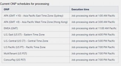

Hi all,
Do we know what is the over night processing window as I am confused whether it between 6PM to 6AM or 7PM to 7AM.
Timezone for the customer would be GMT.
so, if the timezone for another customer is PST then would the ONP window change?
Thanks in advance for your response
Regards
Amit

Hi @amitsharma ,
Below is the list of available ONP schedules along with their execution times. Choose the schedule closest to your customer's time zone for your site.
If required you can covert this time zone using google converter for your easy understanding.
Thanks!

amitsharma
Occasional Member - Level 2
Thanks for the response.
Can you please share the SAP Concur document which has this information.
Hi @amitsharma ,
This screenshot I took long back from one of the support article when I was working on my implementation projects. Currently I shared the same screenshot. This is a standard list of ONP schedules and cannot be customised as per our needs. We need to choose the one closest to our customer’s time zone.
If you still need that support article for your reference then let me know, I will share it tomorrow morning.
Thanks!
Regards,
Pooja
