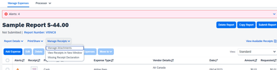

Within the actual report there should be a line at the top that shows "Manage Receipts"
Then choose Manage Attachments
There you can delete whichever receipts you don't need.

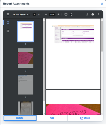

I also am having this problem, nowhere to detach a receipt in either Mobile or Web, and delete is not working. I click delete in manage attachments, and the receipt is still attached to the expense. Even if delete was working, I still would prefer detach so I don't have to re-upload the receipt.
