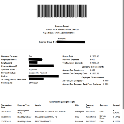

For VAT reclaim purposes in some European countries, our tax department needs us to do a mass download of the expense report cover sheets in pdf format.
Has anyone experienced such a challenge? Does anyone know if there's a way to do this mass download, instead of having to download the cover sheets individually?
Our need comprehends 1431 cover sheets and our deadline is quite tight.

Hi @cmadeira ,
Can you please help me understanding you are referring to exactly what as expense report cover sheet? If you could provide screenshot then it will be helpful to understand.
Hello dear Pooja,
Hope all is well.
Thank you very much for having taken the time to help me.
The company I work for is also based in Europe and although we operate Concur merely in a digital environment, some tax authorities are demanding the Expense report cover sheet as showcased below, for purposes of VTA reclaims. Whilst we have access to the mass download of the invoices via the daily image delivery file, we need to be able to export in mass the expense report cover sheets.
Thanks again and wishes of a good day,
Carlos
Hi @cmadeira ,
This is a printed report that is typically available within each individual expense report.
From a technical standpoint, it is not feasible to export these printed reports in bulk for all expense reports.
Each report must be accessed and downloaded individually.

We also get similar requests. We've built a custom report that replicates the cover sheet which we've used in the past and haven't encountered any issues. Maybe this would work?

Hi - We basically created a custom Cognos report which replicates the cover page. I have a data scientist on my team who was able to build it in such a way that it looks very much like the printed report. The receipts are not downloaded but I provided this detail, and it was accepted by the auditors. I'm not sure if this would fit for you but it worked for us.

Yes, you can pull multiple and have the output in Cognos as PDF. We have run into some volume limitations, but I don't recall off the top of my head what they are. If you have someone on your team that can build a custom report, they should be able to play around to determine if 1400 is too many. If yes, then back it down or shorten the time period.
I've asked for this many times before and Concur has always told me it's not possible. We ended up getting a couple of contractors to manually do it. Hopefully you find a better solution!!
