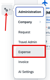

@anna_sz new cost centers would be added using the List Management option. You would need either the Expense Configuration Administrator (restricted) or the Shared Configuration Administrator (restricted role).
Once the appropriate role is added, you would go to the Expense Admin screen and select List Management. Look for a list named Cost Centers. I'm guessing that is the list name. I've provided a screenshot showing how to get to the Expense Admin screen.

Thank you, found it, although it was listed as "SAP Integration Hierarchy" in our system - adding that in case someone has it similar.
