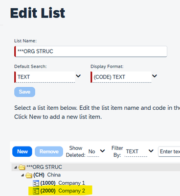

Hi @subali ,
To add new company code in existing org structure you need to do below manual activity:
Role required - Concur Expense Administrator (Restricted)
1. Go to List management >> Find of Org structure list created for your company, which is currently in use. Double click to open and add new company code under China folder. Sample screenshot below:
2. This way you can update entire company 2 structure manually or send it through interface if it is currently in place.
Once org structure list is update, it will reflect everywhere where it is connected. Example, you can update/import employee profiles with new company code 2, user can submit expense reports for new company code 2 etc.
Note - Assuming that company 2 will have some policy requirement as company 1. If company 2 has different policy requirements then it may require other configuration changes.
