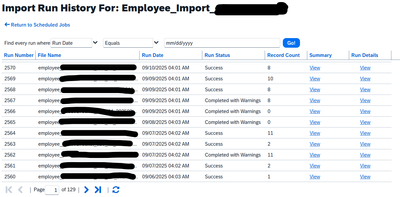

I'm looking for some clarification on the scheduling of Employee Import and List Import processes in Concur.

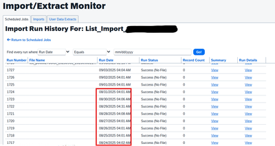

These processes are run by uploading files to an SFTP server. I've been monitoring the Import/Export Monitor, and I noticed that the execution time isn't fixed; it seems to vary daily.
Does anyone know if there's a specific schedule for these imports (e.g., a specific time window or a daily cadence)? Or, do the execution times depend on other factors, such as system load?
