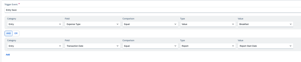

Administration → Expense → Expense Admin → Audit Rules → New
Configure the intended logic: Breakfast eligibility validation
Expense Type = Breakfast
Expense Date = Trip Start Date
Trigger exception: Block or Warn
Illustrative rule logic. The exact comparison depends on which trip-date fields are available in your Concur configuration.
Exception message:
Breakfast expenses are not reimbursable on the first day of business travel. Please remove this expense or contact the Expense Administrator if an exception applies.
SAP supports custom audit rules triggered on entry save or submission, with warning or blocking exceptions.

If you want them to acknowledge that breakfast cannot be claimed on the first day of travel, you could create a Yes/No field that asks, "First Day of Travel?" when Breakfast is selected as the expense type. Make the field required. Then create an audit rule that says If First Day of Travel Equal Yes and Expense Type Equal Breakfast. Set the audit rule exception to 99 to block submission.
Again, the only thing keeping this from working when employees choose No in this field on their actual first day of travel is for Approvers to look at the reports closely. Now that I'm thinking of it, you could create a Trip Start Date field on the Report Header and have another audit rule that looks to see if there is a Breakfast meal that has a transaction date the same as the Trip Start Date. Here is a screenshot I took of the conditions. I used the new Audit Rule UI for it.
