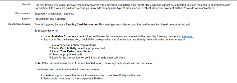

Hi @karineleblanc ,
Attaching similar article for your reference. You can try below suggested solution.
This error is getting triggered bcz for one of the expense entry (Hotel), you might have selected payment type as 'credit card' due to which system is expecting you to link associated credit card transaction.
You can find your credit card transaction in available expenses and move it to the expense report. If it is not yet imported into Concur then you need to wait until it is imported and available under 'Available Expenses' section.

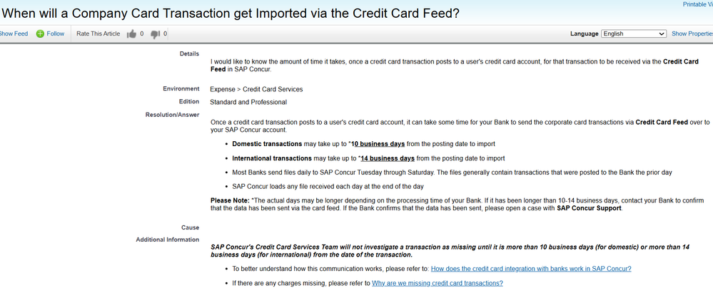

@karineleblanc you might find this helpful as well: Everything You Need to Know About Pending Card Transactions.
karineleblanc
Thank you. I read through your link but the charge show in my Amex on Nov 21st. And still doesn't show in Concur available expense without the pending charges. How long do I have to wait?

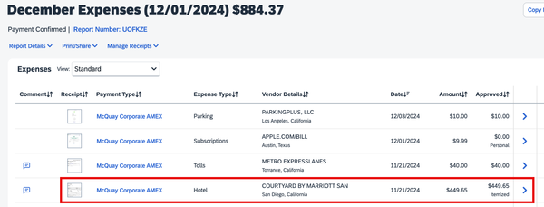

@karineleblanc For future reference if this happens again, always go back and look at your previous expense reports. 99% of the time, the transaction has already been submitted. See screenshot. 🙂
As for the pending item you still have, the article I referenced explains what to do.

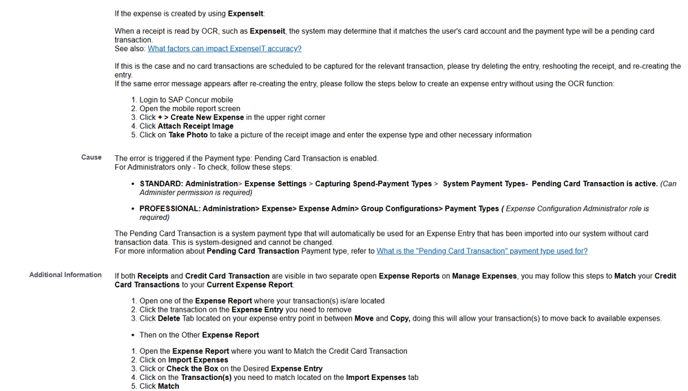

Hi @karineleblanc
Have you followed these steps from the information posted above?
