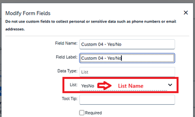

4. Find the field name shown in the screenshot where the "Books, Magazines and Newspapers" values are maintained. Double-click the field, then check the List field and note the List Name currently associated with it.
5. Go to List Management >> search for the same List Name >> double-click to open it >> add the new list items (Name and Code) >> click Save.
