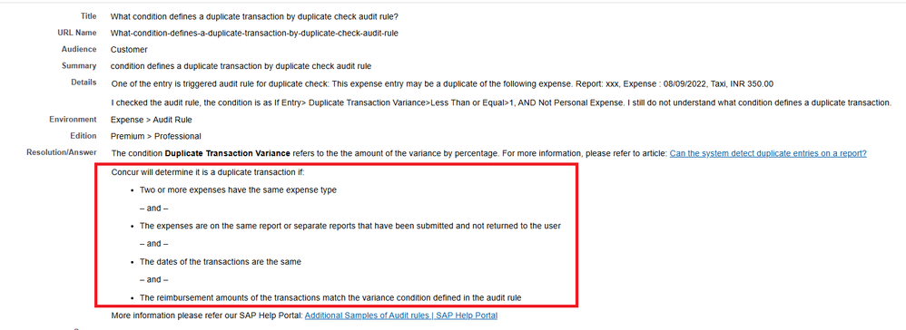

Hi @eileenkline ,
It is possible that the duplicate transaction check rule was not triggered because the February report was not submitted.
Please refer to the duplicate transaction check conditions below. It is possible that one of the conditions may not have been met.
  • The expenses are on the same report or separate reports that have been submitted and not returned to the user
  • The reimbursement amounts of the transactions match the variance condition defined in the audit rule
If required, you can create a dummy report in your admin profile and try to satisfy all of the conditions to check whether the rule is triggered. If it works, it will confirm that one of the conditions was not met in the February report.
Thanks!

Hi @eileenkline ,
Thanks!
