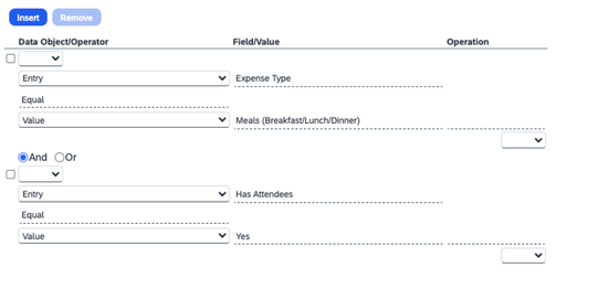

@damedal you could try an audit rule like the one below. The expense type is just an example since I don't know the actual name of the expense type you are referencing.
If you have test users or a test group, I would highly suggest applying the rule to the test user or test group first to try it out. Let me know if this works or not. 🙂
I think w tried something like this before. I will create and try it out.
