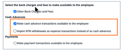

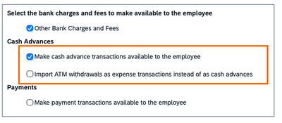

Where is this config that you have highlighted for Cash Advances ?Should i enable both for Cash Withdrawals ? or just the second one "Import ATM Withdrawals" ?
@joshualawrence It is found under Administration>Company>Tools. On this screen look for an option that says Import/Extract Administrator.
I don't think many people have this permission. If you do, when the screen opens, click the Import tab. Look through the list for the correct credit card feed. Click on it then Modify. Scroll down and you'll see the option in the screenshot.
I think you just need the first checkbox selected. That way these will show as Cash Advances which should be more easily distinguishable to users.
