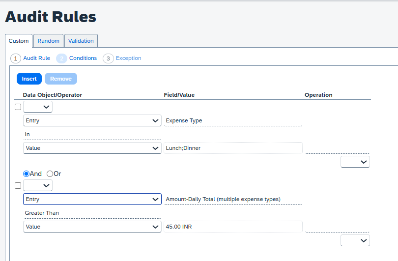

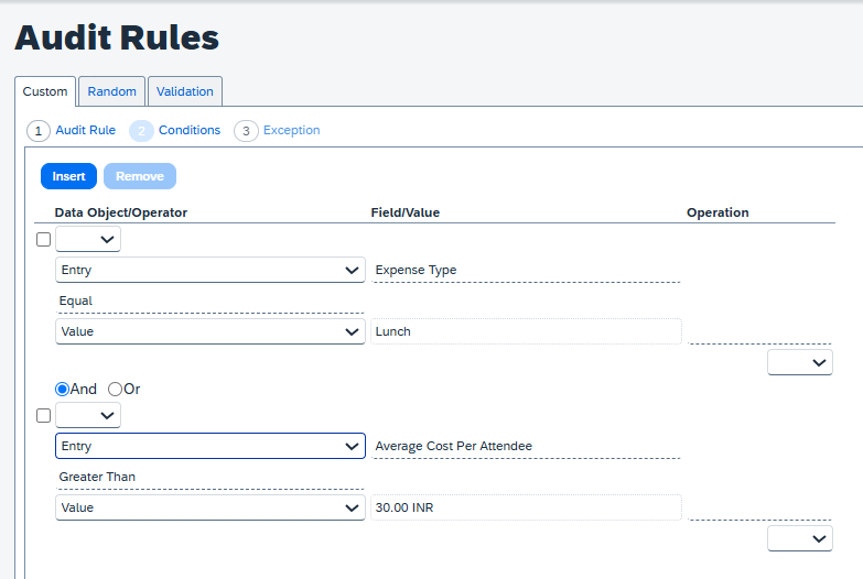

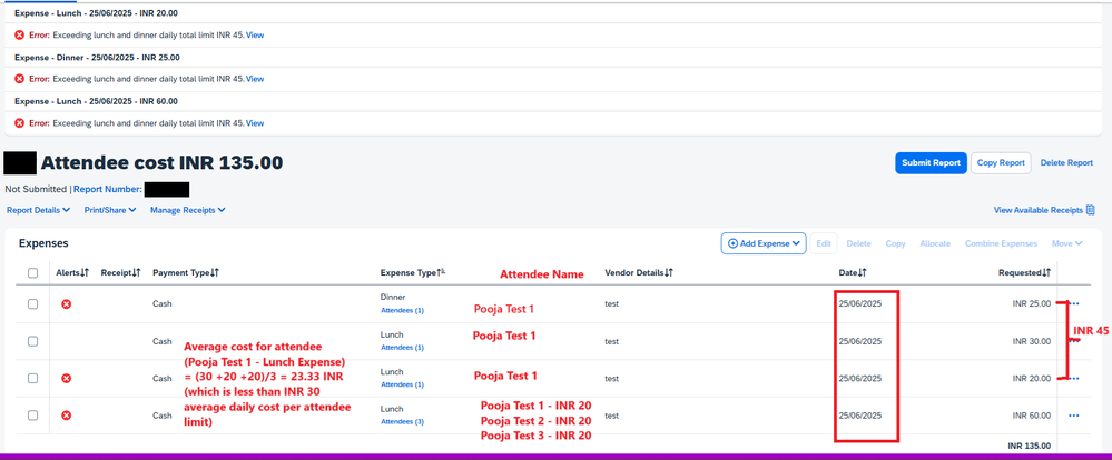

Hi @DadeCavs ,
I tried replicating scenario which you mentioned and could see only one rule is getting triggered that is Amount-daily total (for multiple expense type).
Since, in this scenario average cost per attendee is still within limit that is 30 INR, audit rule 1 did not trigger.
Note - instead of EUR I have used INR currency.
Audit rule 1 - For lunch average cost per attendee
Audit rule 2 - Daily amount total for lunch and dinner
Testing Result:

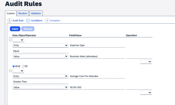

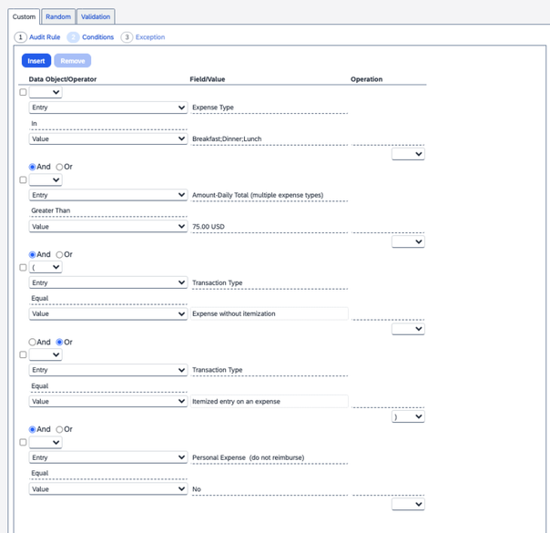

You can create one rule that looks at the individual meal daily total and then a separate rule that looks at group meal expense types with an average cost per attendee over whatever the limit it. I've provided examples. Keep in mind, these are examples from a training site and therefore will have some small differences in expense type names.
This one is for the individual daily limit.
Here is the average attendee cost rule. I used the expense type Business Meal. Yours might be something different. If you want to include other expense types, change the Expense Type Equal to Expense Type In. This would allow you to use multiple expense types in the rule.
