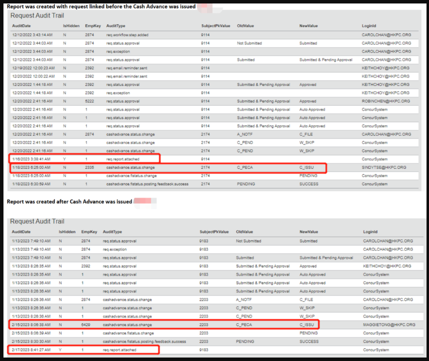

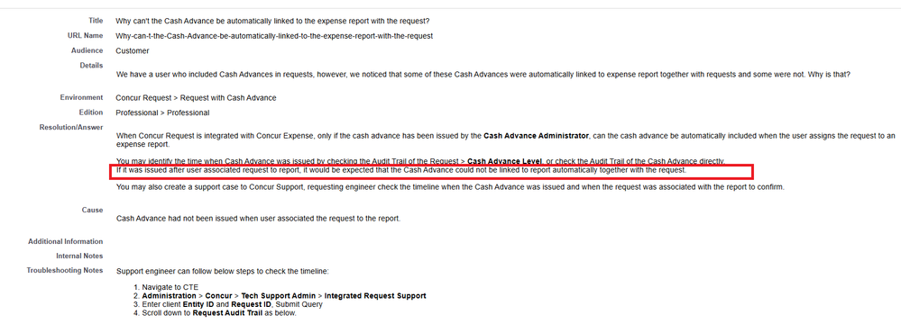

If CA is issued BEFORE Request is linked to Expense report then both Request and CA will get added into expense report.
If CA is issued AFTER Request is linked to Expense report then ONLY Request will get added into expense report.
Note - CA will only get added to report if CA status = Issued in Concur and FI posting status = success.
If CA status = Issued but FI status still shows pending then CA will not be available to add into report.
Attaching similar article below for your further reference purposes.

Hi @AnnaL ,
In ICS integration, if CA is not yet posted into SAP (FI Status= pending) then it will not be available to add into expense report.
CA which are linked to expense reports I'm sure for those CA status would be success. Or possible that those CA are created and linked in report before ICS integration was done or something, however this is just my assumption.
Is it possible for you to get such CA and report samples where we can see when those are issued, linked in which report and report created date. With few samples, we would be able to analyse the issue.
