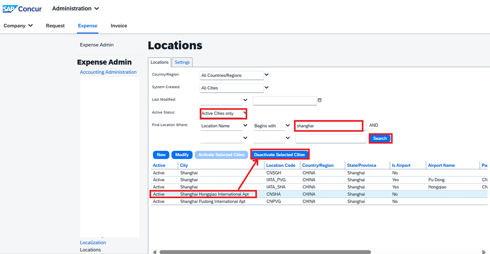

Hi @Jtsoi ,
As per my understanding you query is related to how to deactivate unwanted/other cities from city of purchase. If my understanding is correct then you can follow below navigations:
Role - Expense Configuration Administrator (Restricted/Unrestricted)
Go to Locations >> Search for specific Country/directly search for location name/city >> click on search >> select unwanted location/city name and click on Deactivate Selected Cities button.
Like wise you can do it for all unwanted cities. Once any city is deactivated, it will not appear under city of purchase list.
If you want to deactivate unwanted cities from all countries then I would suggest your to download a location master data from Cognos OR raise a support ticket and get all active city of purchase list >> review and highlight all unwanted cities and again share it with support team and request them to deactivate.
Sample screenshot:
Thank you so much for your sharing. It is something I am looking for.
But I have a questions here. Since this "city of purchase" is shared use by other expense type, if we do the deactivation steps that you shared, is it means this location will also be disappear?

Hi @Jtsoi ,
" But I have a questions here. Since this "city of purchase" is shared use by other expense type, if we do the deactivation steps that you shared, is it means this location will also be disappear? "
Yes , location will be disappear from other expense type as well because this setup is applicable for entire site.
