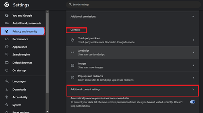

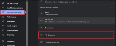

To resolve this issue please do following settings:
1.  Go to Chrom Settings >> Click Privacy and security option
2. Click on Site Settings (bottom last option)
3. Under Content Section >> Click on Additional Content Settings (Expand arrow) - Refer 1st screenshot
4. Click on PDF documents >> Select Open PDFs in Chrome option (as shown below in 2nd and 3nd screenshot)
Once this is done, pdf files will no longer get auto downloaded.
