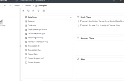

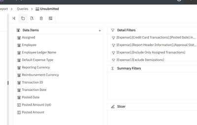

I am trying to modify standard report 'Unsubmitted or unassigned CC transaction' . I want to calculate how much aged that transaction is (i.e. days between current date and posted date). I applied this condition add added a data item :

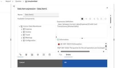

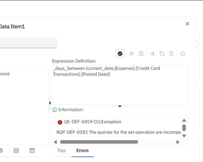

_days_between (current_date,[Expense].[Credit Card Transactions].[Posted Date])
This one not getting added in sub queries unsubmitted or unassigned. So I added in main query, it is added without error. But when I am trying to add in in main page its giving an error like below :
Cross joins (between query subjects: Union1, [Credit Card Transaction Tables].[FCT_CCARD_TRANS Posted Dim_Date]) are not permitted for the user who has the identity '*'.

@Saikat1 the expression you have is correct. You must add it to the Unassigned and Unsubmitted queries separately. Once added to each of these queries, you can then the data item to the Main Query, by selecting the main query, then use the source icon. See screenshot.
We found that the assigned ranking caused the report to error after adding the expression, so if you don't care about the top 10, you can remove the rank expression. You will see this under Summary Filters when you are viewing the Main Query data items.
