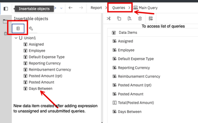

@Saikat1 the expression you have is correct. You must add it to the Unassigned and Unsubmitted queries separately. Once added to each of these queries, you can then the data item to the Main Query, by selecting the main query, then use the source icon. See screenshot.
We found that the assigned ranking caused the report to error after adding the expression, so if you don't care about the top 10, you can remove the rank expression. You will see this under Summary Filters when you are viewing the Main Query data items.
I hope this helps. Good luck. 🙂
