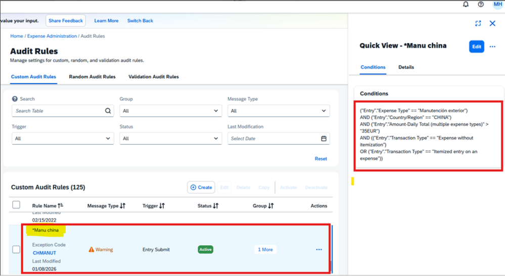

Hi,
Issue: Audit rule is not distinguishing daily limits by country/region, causing false alerts.
Expected Behavior: Validation should apply independently per country according to defined policies
Our policy includes a daily limit by country for expenses categorized under "Manutención Exterior." To manage these expenses effectively, we have established an audit rule for each country, each with its own specified limit.
However, during our testing of this rule, we discovered a malfunction. When there are two entries for "Manutención Exterior" on the same day from different countries, Concur combines all the amounts without distinguishing the country of origin. This leads to an incorrect alert indicating that the daily limit for one of the countries has been exceeded.
Has anyone experienced the same problem?
Happy to hear your comments.
Thanks and regards.
Maria.

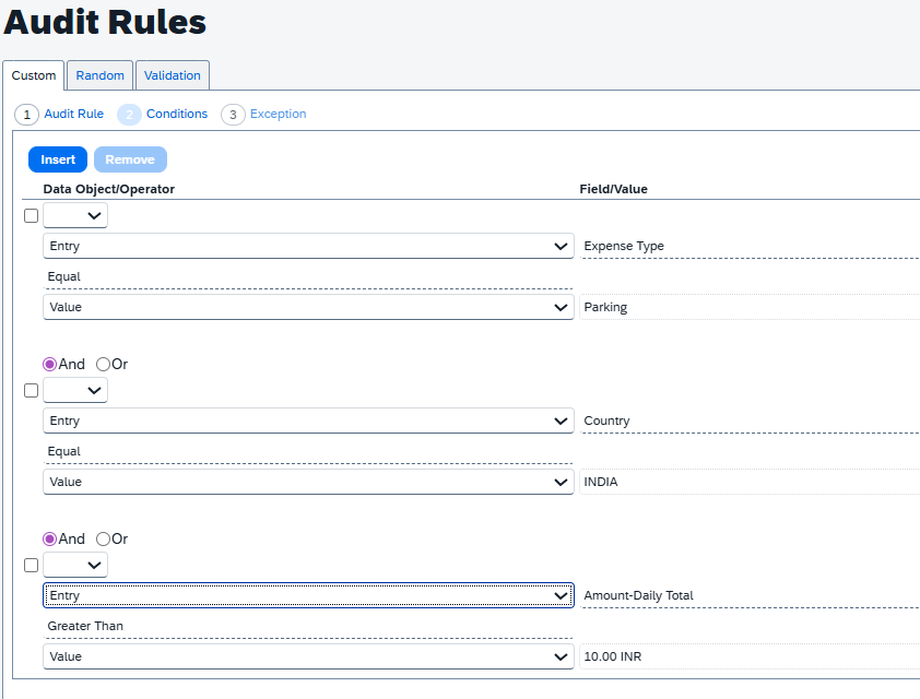

Hi @MEcnx ,
Can you write your audit rule conditions as shown below. Instead of "Country/Region" data object, try using "Country" and test.
I tried testing my audit rule in our sandbox for two different countries and it is working fine for me.

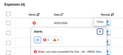

Sample test limit and test result:
IN - INR 10
UK - INR 20

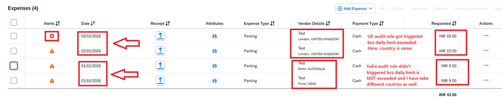

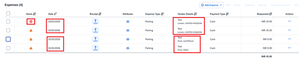

Hi @MEcnx ,
Yes, I have used the same transaction date.
UK limit - INR 20
IN limit - INR 10
Thanks!
Regards,
Pooja
MEcnx
Occasional Member - Level 3
Hi @PoojaKumatkar
That's not correct, you put 02/01/2026 for the transactions in UK and 01/01/2026 for the transactions in INDIA.
Try puting all the transactions with the same date. The user was in two countries at the same date.

MEcnx
Company Policies
  • China: Daily limit for “Manutención Exterior”EUR 35
    • Audit Rule Name: Manu China
  • Spain: Daily limit for “Manutención Exterior”EUR 30
    • Audit Rule Name: Manu Spain

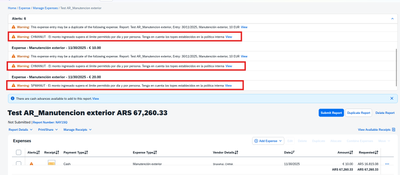

TEST SCENARIO
The user submits an expense report with the following entries:
Entry
Transaction Date
Expense Type
City of Purchase
Country/Region
Amount (EUR)
1
30/11/2025
Shanghai
China
10
2
30/11/2025
Shanghai
China
10
3
30/11/2025
Madrid
Spain
20
EXPECTED RESULT
The expense report should be submitted without alerts, because:
  • In China, the daily total is 20 EUR, within the limit of 35 EUR.
  • In Spain, the daily total is 20 EUR, within the limit of 30 EUR.
TEST EXECUTION
1. The user enters each expense into the report.
2. The user submits the report.
3. SAP Concur triggers the alerts:
    • CHMANUT: “The amount entered exceeds the daily limit per person. Please note the caps established in the internal policy.”
    • SPMANUT: “The amount entered exceeds the daily limit per person. Please note the caps established in the internal policy.”
ACTUAL RESULT
Failed – The alert is triggered incorrectly.
  • The system aggregates all Foreign Meals entries for the same day, without distinguishing the country of origin.
  • This causes the system to interpret an excess, even though each country’s expenses are within its respective policy.

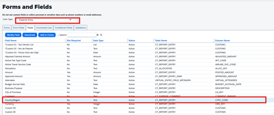

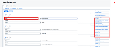

Hi @MEcnx ,
Can you please check whether these expense entries contains attendees in it?
Also, have you tried updating audit rule data object to "country" instead of "country/region". Can you please try once.
Thanks!
Regards,
Pooja
MEcnx

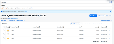

The expenses haven't arrendees in it, actually they haven't that option. (see image)
Related with Data Object, teh only option we have is Country/Region
But I think that it is the same as yours

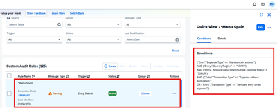

@MEcnx what is the rule name you are working on and what is the test user's name? I'd like to take a look.

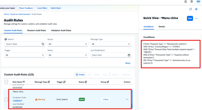

Hi @KevinD ,
Please check audit rule names below:
*Manu china
*Manu Spain
Also, I tried replicating same conditions as given here in Mecns's rule, for me rule is still working fine.
Thanks!
Regards,
Pooja

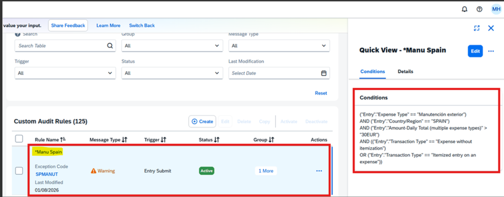

@PoojaKumatkar got it. Do you have screenshots of your rule conditions so we can compare them?

@PoojaKumatkar Good find. I found it odd that country was being used, but for no other reason than it wouldn't match the currency used in the rule.
@MEcnx you might need to find another creative way to get the rule to work how you want it.
In your original post, you said you have limits by country...meaning that if Employee A travels to Spain, they can only spend so much per day on that expense type, correct?
What I would consider having you do, is create a custom field for Country and have all countries where you plan to have limits listed in a drop down list. You could then create a rule that uses this custom field. Now the question is, how many countries will have a limit associated to them for this expense type? I mention this because you might have to create different versions of this rule...one for each country with the daily limit.
What users would do is select the country from this custom field so the appropriate limit rule would come into play. The only tricky part would be if for some reason the employee happened to travel to two of the countries on the same day, but this seems a little unlikely.
Anyway, something to consider.

MEcnx
@PoojaKumatkar  Thanks for sharing your findings.
@KevinDI agree with you that creating separate expense Types for each country that has daily amount limits is ineffective.
It's correct, I have different limits By Country, let me share it with you
It is common for us to be in two countries in one day, as neighboring countries are often just an hour apart.
I considered creating a Custom field for Country, but this may not provide the best user experience. However, it could be a potential solution.
@PoojaKumatkar  setting Daily Transaction Total = 1.  I think that is not possible for us because the Expense Type "Manutencion exterior" covers multiple concepts. Think of it as a Miscellaneous expense, which means you could have several receipts under that expense type (such as from a coffee shop or a convenience store, etc.).
Thanks and regards
Maria
@MEcnx I'm going to go with my custom audit rule and custom field. Maybe name the custom field Destination. I think this is the only way you can have the system flag something if it is over the daily amount and have it based on country. You would need to create separate rules for each Destination. That way if a user does travel to two different countries in the same day, one rule will evaluate the daily total for the first country visited that day and another rule will evaluate the daily total for the second country visited. I haven't tested this, but in theory, I think it should work.
MEcnx
Hi Kevin,
Thank you for your assistance in resolving this issue.
The scenario when the rule is not working as expected is when the user submit expense Type "Manutencion exterior" from two different countries (China , Spain) with the same Transaction date.  Like the example I posted before.
Thanks
Maria
