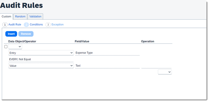

@probconcsol I found your question to be quite intriguing, so I asked around. What you are asking is possible and as it turns out, quite easy to do. I've provide a screenshot below using Taxi as the expense type. You would just need to swap in your expense type "x" where it shows taxi. The audit rule should be built to fire on Report Submit and be sure you create the exception will level 99.
